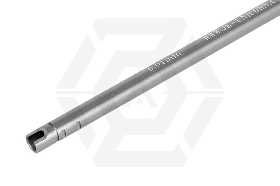

For an inner barrel, any AEG 270mm inner battle will fit, there are quite a few choices, including standard brass, MadBull tightbore or a PDI tightbore. You may as well upgrade to a tightbore, MadBull are quite good for the money, but if you want better, then PDI are the ones to go for, and their 270mm inner isn't actually too much more expensive than MadBull, costing £30+ shipping and VAT from their website: http://www.x-fire.org/etop/05.html They're actually offering free shipping until 20th April, so now wouldn't be a bad time to buy (still gotta pay VAT).

Inner barrel you need one around 240-270mm or if you want to save some money, cut down your existing one.

It shouldn't do, maybe a slight drop in FPS, but if you get a tightbore, then that'll increase the FPS, so you shouldn't see any large change either up or down.
